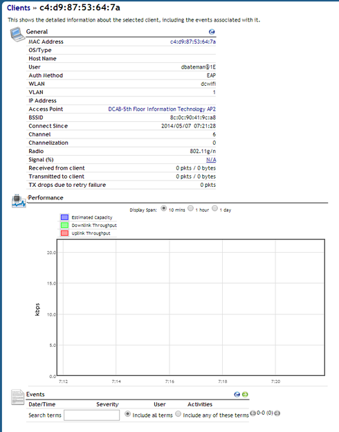

Ok so here is an update. When I try to connect with the Zero IT WLAN nothing shows up in the events/activities. But the AP I am connecting do does see me. See attached) Image_ images_messages_5f91c415135b77e247954139_0e804e1a6520df48c4c85f9fd02c8dd4_Ruckus_Client_inline-50e35cbe-fe93-4ece-90fd-805a9b8d9318-596573304.png1399462378
But it shows that I'm not pulling an IP.
When I connect the laptop to a different WLAN that does not use Zero IT and is on the same AP it does connect and works fine. That leads me to believe its something with the certificates that are being issued by ZD.
I also verified and the Zero IT WLAN is on the correct VLAN.

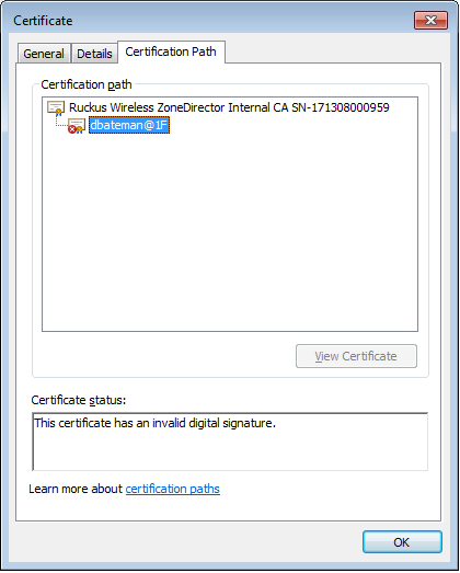

I check the certificate chain and there is no intermediate cert. Image_ images_messages_5f91c416135b77e2479579a7_2fa93d85960a8ea2f651df1c02f5c5e7_Cert_Issue02_inline-6eae6e63-ec5b-48c8-baf0-c740da56460d-289120837.png1399904261
It does say that the user Certificate has an invalid signature. Could that have something to do with the issue? Could the ZD be messing up with the cert generation?
