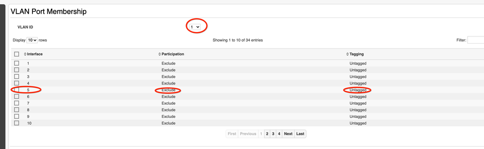

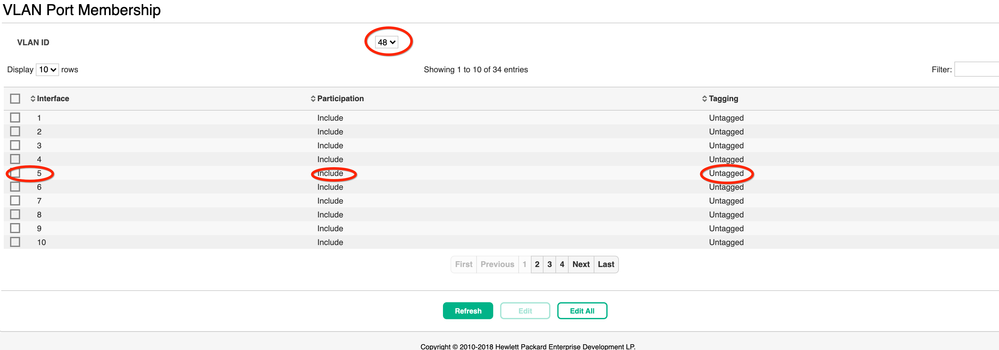

As you can see, this switch is connected to AP via interface5 and the untagged traffic is for vlan48, which groups all APs. Vlan1 is untagged too but excluded and I think that is normal as a port can't handle untagged traffic for more than a vlan.

So in the above configuration, your switch port 5 is configured with Untagged VLAN48. Right?
Now come to client DHCP. Depending upon what VLAN is configured on the WLAN, on which your client is connecting, AP will send the DHCP frames.
Lets say, if WLAN/SSID is configured with VLAN20 (and same is tagged on the switchport), then AP will send a tagged DHCP frame out from its ethernet interface and then that frame will hit the gateway of VLAN20 (assuming there is no other L3 device which is acting as relay agent).
