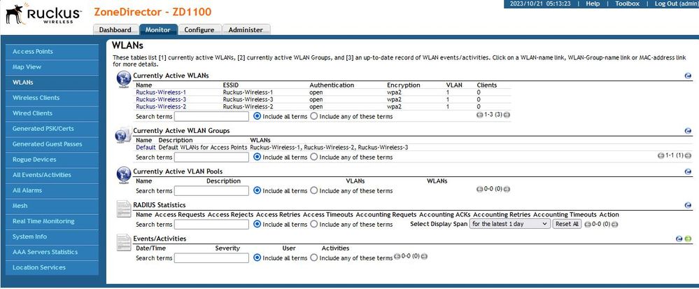

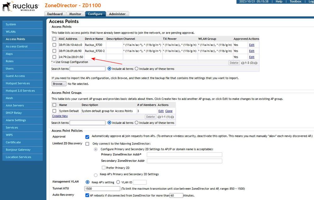

While I was waiting on further information on my ZD1100 and R700 and why I can't access the internet, I started working on my third device. I am setting up a n H500. Everything is going fine, but when I query the ZD1100, I notice that it sees all three devices but the H500 shows inactive with an error message. See the screenshot images attached.
I don't know if there is a more current firmware. I have searched but can't find anything. But I don't think the firmware would prevent me from connecting to the internet. Can you help me please?
