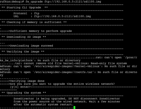

Thanks for your detailed reply. The firmware in my ZD1100 is 9.5.0. When I tried to upgrade the firmware, it stopped half way, here is the screen cap:

Hi Michael,
ZD1100 is a old device with limited hardware resources, hence upgrade may take more time.
If you do not see anything happening for a long time (for more than 15 minutes) then you can try rebooting the ZD and wait for it boot up.
If issue is still not resolved, please open a case with support.
