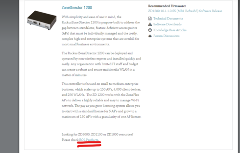

Hi Martin,
It's under EoL products in ZD section. Very bottom of the page.
https://support.ruckuswireless.com/products/29-zonedirector-1100#firmwares
Make sure you read the product release notes to follow the upgrade path.
Cheers,
Alex
Cheers,
Alex
