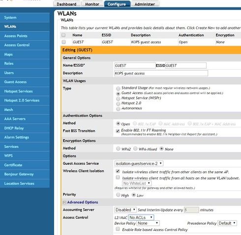

Looking at the ZD GUI you can add MAC addresses to the guest WLAN...is this what you are after. Need to create the ACL MAC list then choose from the "Access Control" drop down selector. Bottom of image...

The L2 ACL is going to allow/deny folks from connecting to the WLAN at all, but I don't think it will do anything as far as bypassing the captive portal for those devices listed.
Would it be feasible in your environment to use DPSK for gaming devices?  I do this for some of my higher education customers for devices that don't support radius.  You could bring up another SSID, use the same VLAN as your guest network, even configure client isolation, and that would not require you to set up any additional firewall rules if your guest VLAN is already configured the way you need.  You then generate DPSKs for your users gaming devices and have them use those keys.

I was looking for ip ranges or something i can look for in the packets rather than ports to allow for xbox live. Allowing port 80 outbound I may as well leave the network open and unauthenticated for all clients.
DPSK is probably what im looking for in terms of accountability and compatibility. I don't really need to log what games consoles are doing on the network, so I may use this with a hint of MAC filtering on the firewall side to make sure the keys don't get used on none gaming devices.
