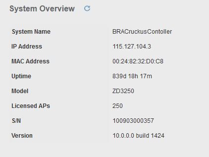

I want to add Zoneflex R510 to Controller ZD3250(version 10.0)
Please confirm
08-11-2022 02:30 AM
R510 is supported in ZD version 10.0.x.
It is recommended to go through release notes before every upgrade to check the supported APs.
