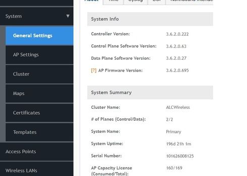

09-25-2020 07:33 AM
Thanks, I must have a different version of firmware, as I dont have a SYSTEM>SYSTEM SETTINGS. I have done a screen shot.
