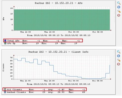

Thank you about your suggestion. The problem has been fix since I change the CF Type from "LAST" to "AVERAGE".
But I have found some unactive OID, I did snmpwalk but the result was not OK. So, it make the graphs didn't display properly.
Image_ images_messages_5f91c46b135b77e247a77d80_b774f860a81448c376a1827d271a9bc0_RackMultipart2015100218677cn7s-b7651c02-2089-4575-8349-b4bf4559279e-1271020141.jpg1443751736
The OID is:
APs Total - result: NOK        1.3.6.1.4.1.25053.1.2.1.1.1.15.15.0
All Clients - result: NOK        1.3.6.1.4.1.25053.1.2.1.1.1.15.30.0
Do you know how to fix it? I tried looking the SNMP OID from ruckus SNMP reference guide, but I have not found yet which OID should be used.

I don't have much of an idea of what is wrong with the graphs you show as mine do not have this problem. I'm not an SNMP/Cacti expert and also do not know what "NOK" means as a result.
Sorry I can't be more help.
-Joel
alvinp
New Contributor III
Yes, the graph is showing normal in my ZD ver 1100 but not in ZD1000. And I thought that is also working normal for ZD1100 above version, cmiiw
I didnt know why that could be happened, Then i did snmpwalk of these APs Total OID  1.3.6.1.4.1.25053.1.2.1.1.1.15.15.0 and  All Clients  OID 1.3.6.1.4.1.25053.1.2.1.1.1.15.30.0. And the result was Not OK, "NOK".
Sorry for misunderstanding.
So, now i am still looking for exact for those OID.
Maybe someone here knows how to work with that issue?
