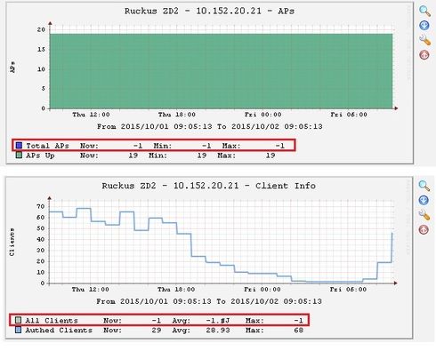

Hi Joel,
Thank you about your suggestion. The problem has been fix since I change the CF Type from "LAST" to "AVERAGE".
But I have found some unactive OID, I did snmpwalk but the result was not OK. So, it make the graphs didn't display properly.
The OID is:
APs Total - result: NOK 1.3.6.1.4.1.25053.1.2.1.1.1.15.15.0
All Clients - result: NOK 1.3.6.1.4.1.25053.1.2.1.1.1.15.30.0
Do you know how to fix it? I tried looking the SNMP OID from ruckus SNMP reference guide, but I have not found yet which OID should be used.
Thanks,
The OID is:
Thanks,

I don't have much of an idea of what is wrong with the graphs you show as mine do not have this problem. I'm not an SNMP/Cacti expert and also do not know what "NOK" means as a result.
Sorry I can't be more help.
-Joel
-Joel
Options
- Mark as New
- Bookmark
- Subscribe
- Mute
- Subscribe to RSS Feed
- Permalink
10-09-2015 12:15 AM
Yes, the graph is showing normal in my ZD ver 1100 but not in ZD1000. And I thought that is also working normal for ZD1100 above version, cmiiw
I didnt know why that could be happened, Then i did snmpwalk of these APs Total OID 1.3.6.1.4.1.25053.1.2.1.1.1.15.15.0 and All Clients OID 1.3.6.1.4.1.25053.1.2.1.1.1.15.30.0. And the result was Not OK, "NOK".
Sorry for misunderstanding.
So, now i am still looking for exact for those OID.
Maybe someone here knows how to work with that issue?
