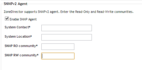

I'm looking at doing this same thing through MRTG. However, I can't figure out how to enable SNMP v2 on my AP's that are controlled by a Zone Director.
Anyone able to give me a quick idea of where to set this?
Thanks!
jason
dilojunior
New Contributor III
Hi Jason,
On the Config Tab, Menu->System you have a "+Network Management" link, at the end of the page.
Just click it and you will have access to enable SNMPv2
Image_ images_messages_5f91c40a135b77e2479302d5_da52157512cbab0bb394f237f916ccf1_snmpv2_inline-ba78cf40-4d7d-4423-9e85-fd0741aeb567-2060256081.PNG1382721992
You can use the same communities to get SNMPv2 data from APs connected to ZD.
