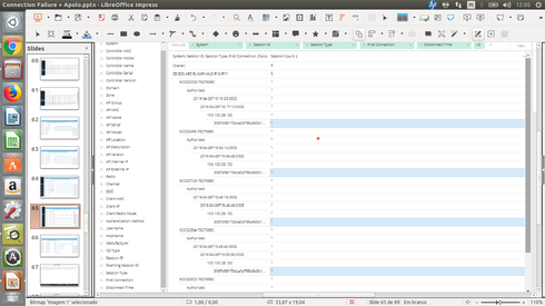

6 - The same user of item 5, has 5 sessions in SCI. I need to know what the metric is, because in the view of the controller this user is unique, but why in history does he report with 109 entries in the SZ300, and "only" 5 sessions in SCI? What is being evaluated? This scenario is with all my clients, and the numbers are dissenting.

For #6 - Could be related to disconnection/connection so different session starts/stops and times.
