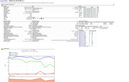

I have a big problem into a building here, with the WiFi.
Actually users complain about speed of APs, so what I already did :
- Did a complet site survey with Ekahau Site Survey
- Move/remove a lot of APs for remove Overlapping and get a good strengh of signal
- Remove the 2.4 Ghz, like that users can connect only with 5 Ghz.
Unfortunetly, the last step was a disaster... users complain more than before.
Specialy some girls who are on a specific room. When I see the information of the concerned AP, OMM it's not normal at all.
Image_ images_messages_5f91c3db135b77e2478b23ba_d5fc05c48abbc7d3e4bc361614e5dcbf_RackMultipart20160415610631aw5-df986b3c-e89f-419e-bca8-e821df7e5b3b-1917588897.png1460725362
The estimated Capacity is very low and I dont know what's wrong and how I can solve the problem.
If anyone have an idea ?
Thanks a lot 🙂

Hi JS,
I checked the APs neighbour list and I see the overlap has come pretty less to 17 db and so. I am not sure how far the nearby APs are to Rolle -mo Rc access point.
I can also see 4,5 and 9 db which are apparently very less. Please make sure that 5 Ghz have shorter wavelength and they do not transverse through thick concrete walls.
I would suggest to enable 2.4 Ghz first so that clients connects and then find the reason for low throughput.
Check the throughput or speed using speedflex on both 2.4 and 5 ghz individually. Simultaneously check the wired speed by connecting a laptop to the switch.
By downloading the support file from the AP, check the phy errors and see if interfernce is not causing this.
If it is an issue with interference, try manual channels and see if that works.
Hope this helps.
Ahamed.

Hi JS,
I meant to say 4 db, 5 db and 9 db in neighbor AP list. The APs are overlappiing with very less overlap. But then these are using 5 Ghz.

It's best to confirm your wired layer is performing as a start.
Run a SpeedFlex to all your APs to confirm they're running gigabit speeds and that there isn't a backhaul issue.
Run a 10-15 second ping test from a machine at your core switch/AP switch to all AP's to ensure latency is good and there is no packet loss to APs.
Consider dropping your 5GHz from 80MHz channels down to 40MHz channels.
Walk around with a client laptop, one connected at 2.4GHz and one at 5GHz and run a ping check to test the latency in trouble areas.
Consider spectrum analysis in the trouble areas.
