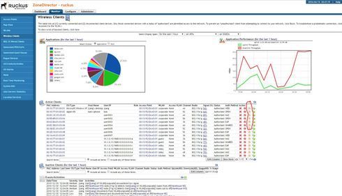

Speedflex is nothing but a ruckus propreitary tool to test the speed.
You can find the speedflex on the monitor >> access point page. You can also go to clients and check the speed using speed flex as shown below.
Speedflex is also available in app store for iOS and android devices.
Hope this helps.
