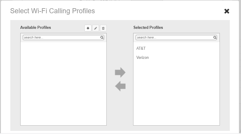

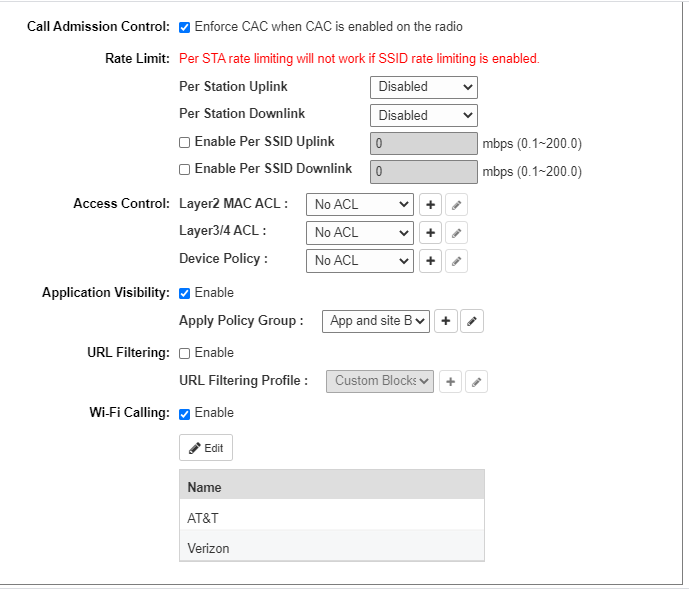

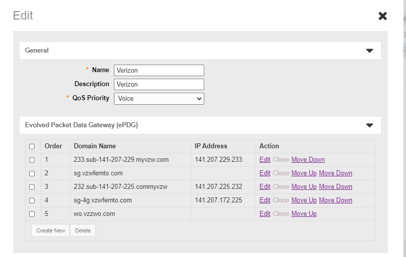

I configured it for both Verizon and ATT, and none work.  I did enable WiFi calling on my cell, and I see it using Wifi,
Image_ images_messages_606ceb323408123fa7a27af2_e83f1fad2d5b8855a79900c2b0a799a7_wificalling1-fd846422-35ae-42d4-bcf3-b2a4665771b3-1863149539.PNG
Image_ images_messages_606ceb323408123fa7a27af2_9d9da459ed60c64b96589284188feed1_wificalling2-484cd50e-84e9-4c80-a843-9d3c8b514d5a-1862226018.PNG
Image_ images_messages_606ceb323408123fa7a27af2_39d25e052cf34a630777f35e0c33e258_wificalling3-16061d96-2740-4ec5-8a06-b6b997ff8a03-1861302497.PNG
but the logs show nothing.

Hi Dariusz,
As long as your phone has WiFi connection and can reach the ePDG gateway of ISP, VoWiFi should work.
Options given in controller is just to make experience better and smooth, but if WiFi calling is not working at all, you may have to troubleshoot further or open a support case.
Packet capture on APs eth interface will help why calling is not working.
Once you enable WiFi calling on your phone, it sends a DNS request to ISP's ePDG gateway, if DNS is not resolved, feature will not work.
If DNS is resolved, your phone will establish a ISAKMP tunnel with ISP's gateway and start sending ESP encapsulated voice traffic to the gateway.
If you are interested in in-depth troubleshooting, below is the connection flow of VoWiFi.
Client DNS query to epdg gateway, such as "epdg.epc.mnc002.mcc262.pub.3gppnetwork.org" or depending upon client's Telco it could be different name ending with .3gppnetwork.org>> DNS response >> ISAKMP Init request >> ISAKMP responder response >> Auth Init request >> Auth response >> data traffic as ESP (Encapsulating Security Payload).
