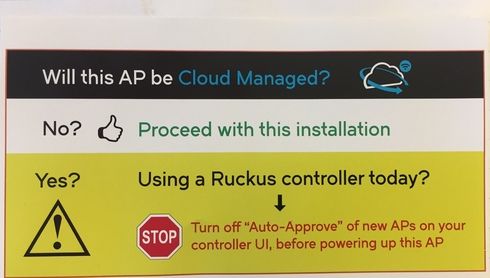

Couldn't find any other threads on this subj, so adding my own comment.
In this way it is virtually impossible to pre-provision Unleashed at home, if you have Unleashed AP's of your own. I'm on 200.5.10.1.291 and (still) cannot disable 'Auto Approval' on my exisitng Unleashed, causing my new AP's to be 'stolen' too. Besides, my new AP's still have this label inside the plastic wrapping....Image_ images_messages_5f91c464135b77e247a577bc_e521448d7c5b28d72dd41c884f1fff1d_RackMultipart20180209547331h8w-4b9118eb-747d-45cd-b826-373680e50ce7-1323242060.JPG1518164824
Hi Jesper,
     By design you cannot pre-configure an Unleashed network, nor set it up remotely.
We have a knowledge base article with setup details that can be shared with remote
admins if needed.
