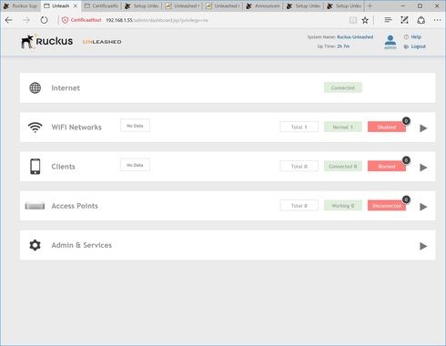

Here is the overview:
Here the AP screen:
So, what do you think? Like I said: I have two of those acting the same. They are both configured and powered up now.
Here the AP screen:
