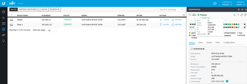

So 2 out of 3 AP's are working on unifi Switch on POE+ and right now its consuming only 4.33 watt. But the 1st AP which i sed on this switch is not working on POE+ or eather24v Passivs.
But its working fine on non manageble POE switch.
I also check the power mode its Auto.
So the problem is in Ruckus as 2 other AP's are working fine.
