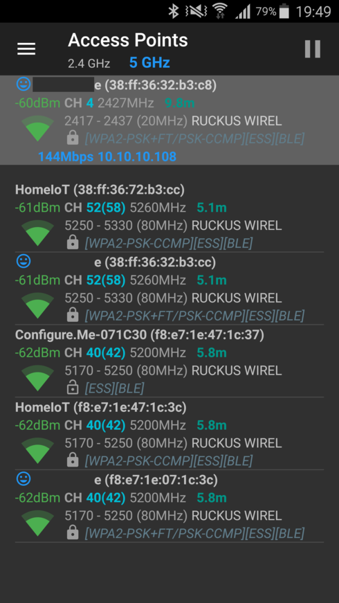

I have a problem - R500 recurrently broadcasts an open network Configure.Me.
That network is only on 5Ghz (as I understood from documentation it should be broadcasted only on 2,4Ghz and only during first configuration).
Get wlanlistname shows all inactive bssid as 00:00:00:00:00:00, with one exception - wlan103 is down but bssid is " f8:e7:1e:47:1c:37".
How can I disable broadcasting Configure.Me ?
rkscli: get wlanlistname status type wlanID radioID bssid ssid
wlan0 up AP wlan0 0 f8:e7:1e:07:1c:38 e
wlan1 up AP wlan1 0 f8:e7:1e:47:1c:38 HomeIoT
wlan2 down AP wlan2 0 00:00:00:00:00:00 Internet
wlan3 down AP wlan3 0 00:00:00:00:00:00 Plus 8
wlan100 down MON wlan100 0 00:00:00:00:00:00
recovery-ssid down AP wlan102 0 00:00:00:00:00:00 Configure.Me-071C30
wlan32 up AP wlan32 1 f8:e7:1e:07:1c:3c e
wlan33 up AP wlan33 1 f8:e7:1e:47:1c:3c HomeIoT
wlan34 down AP wlan34 1 00:00:00:00:00:00 Internet
wlan35 down AP wlan35 1 00:00:00:00:00:00 Plus 8
recovery-ssid down AP wlan103 1 f8:e7:1e:47:1c:37 Configure.Me-071C30
OK

i fear that R50O has not joined the Unleashed network correctly...
do you see R500 listed as connected AP as master AP or standby AP?

Yes I see R500 as standby AP
ruckus# show ap all AP: ID: 1: MAC Address= 38:ff:36:32:b3:c0 Model= r600 Approved= Yes Device Name= R 600 Description= Location= GPS= CERT = Normal Bonjour-policy= Group Name= System Default Channel Range: A/N= 36,40,44,48,52,56,60,64,100,104,108,112,116,120,124,128,132,136 (Disallowed= ) B/G/N= 1,2,3,4,5,6,7,8,9,10,11,12,13 (Disallowed= ) Radio a/n: Channelization= Auto Channel= Auto WLAN Services enabled= Yes Tx. Power= -6dB(1/4) WLAN Group Name= Default Call Admission Control= OFF SpectraLink Compatibility= Disabled Radio b/g/n: Channelization= Auto Channel= Auto WLAN Services enabled= Yes Tx. Power= Auto WLAN Group Name= Default Call Admission Control= OFF SpectraLink Compatibility= Disabled Override global ap-model port configuration= No Network Setting: Protocol mode= Use Parent Setting Device IP Settings= Manual IP Address= 10.10.10.203 Netmask= 255.255.255.0 Gateway= 10.10.10.1 Primary DNS Server= Secondary DNS Server= Device IPv6 Settings= Keep AP's Setting
IPv6 Type= Auto Configuration IPv6 Address= IPv6 Prefix Length= 0 IPv6 Gateway= IPv6 Primary DNS Server= IPv6 Secondary DNS Server= Mesh: Status= Disabled LLDP: Status = Use Parent Setting LAN Port: 0: Interface= eth0 Dot1x= None LogicalLink= Up PhysicalLink= Up 1000Mbps full Label= 10/100/1000 PoE LAN1 1: Interface= eth1 Dot1x= None LogicalLink= Down PhysicalLink= Down Label= 10/100/1000 LAN2 2: MAC Address= f8:e7:1e:07:1c:30 Model= r500 Approved= Yes Device Name= R 500 Description= Location= GPS= CERT = Normal Bonjour-policy= Group Name= System Default Channel Range: A/N= 36,40,44,48,52,56,60,64,100,104,108,112,116,120,124,128,132,136 (Disallowed= ) B/G/N= 1,2,3,4,5,6,7,8,9,10,11 (Disallowed= 12,13) Radio a/n: Channelization= Auto Channel= Auto WLAN Services enabled= Yes Tx. Power= -6dB(1/4) WLAN Group Name= Default Call Admission Control= OFF
SpectraLink Compatibility= Disabled Radio b/g/n: Channelization= Auto Channel= Auto WLAN Services enabled= Yes Tx. Power= -6dB(1/4) WLAN Group Name= Default Call Admission Control= OFF SpectraLink Compatibility= Disabled Override global ap-model port configuration= No Network Setting: Protocol mode= Use Parent Setting Device IP Settings= Keep AP's Setting IP Type= Static IP Address= 10.10.10.204 Netmask= 255.255.255.0 Gateway= 10.10.10.1 Primary DNS Server= 10.10.10.220 Secondary DNS Server= 8.8.8.8 Device IPv6 Settings= Keep AP's Setting IPv6 Type= Auto Configuration IPv6 Address= IPv6 Prefix Length= 0 IPv6 Gateway= IPv6 Primary DNS Server= IPv6 Secondary DNS Server= Mesh: Status= Disabled LLDP: Status = Use Parent Setting LAN Port: 0: Interface= eth0 Dot1x= None LogicalLink= Up PhysicalLink= Up 1000Mbps full Label= 10/100/1000 PoE LAN1 1: Interface= eth1 Dot1x= None LogicalLink= Down PhysicalLink= Down Label= 10/100/1000 LAN2
