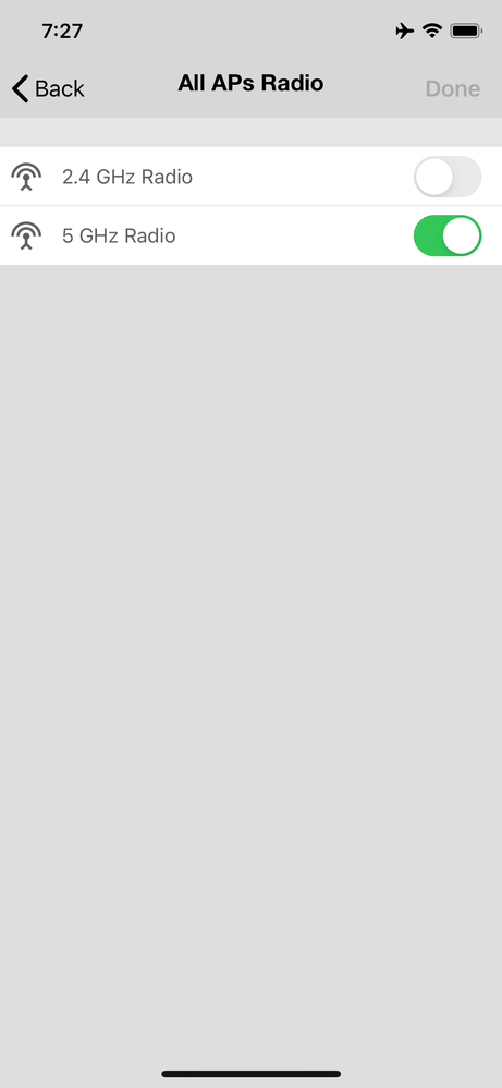

I turned off the 2.4 radio, still the same sub par performance.
