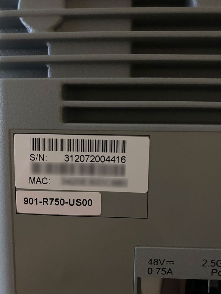

I purchased this from Amazon (Global Direct Sellers) and it appeared to be new and sealed as far as I can tell.
I just called support...
They would not help me because I bought this from Amazon and said this is likely gray market device. I mean...
He never asked for a serial number or a way to validate if it was an authentic product in my hand.
I find this disgraceful not to know and or support your product.
It's fine if it has no warranty, that's one thing. But if it's a valid genuine product why the hell would they just want to get off the phone and not even check.
It would be nice to know if I got a gray market product and help me make sure I buy the correct product. That seems reasonable.

You can check the product warranty and service status from our support portal, below link already have your S/N populated. You can see it has no warranty nor support associated to it. Product service support can only be activated when purchased from one of our authorised resellers which Amazon is not. That's why support desk does not need the S/N to look up and determined no warranty/support activated for your product.
You can also find our warranty statement below.
https://www.commscope.com/globalassets/digizuite/1077-1067-ruckus-warranty-statement.pdf
