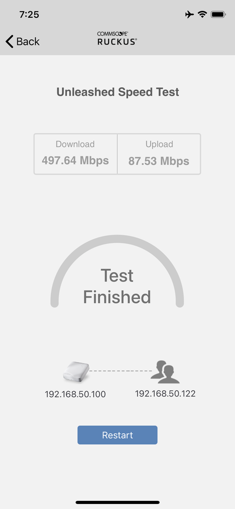

I will also run iPerf3 tests between server (iMac) and iPhone to test the speed of the hardware minus the ISP. This will rule out any ISP issues. I still think hitting the same 450 Mpbs as a Cat 6 cable via the iPhone 11 Pro via the 2x2 WiFi 6 chipset should be easy.

I turned off the 2.4 radio, still the same sub par performance.
