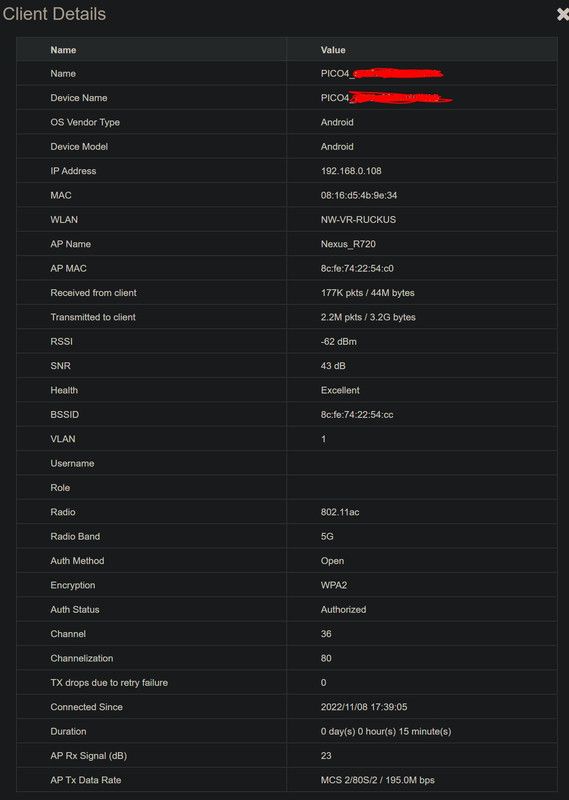

Meanwhile here is the details tab from the AP and the "client"
Details

Sorry for the late reply. I've managed to install Speedflex on my device and run the tests:
Speedflex 1
Speedflex2
Speedflex 3In case it's difficult to read, the results are as follows:
Report 1
0% packet loss
Download = 127.8 Mbps
Upload = 357.2 Mbps
Frequency 5180mhz, Signal -51dB and Channel = 36
I was reaching 1200Mbps with this same config before !
