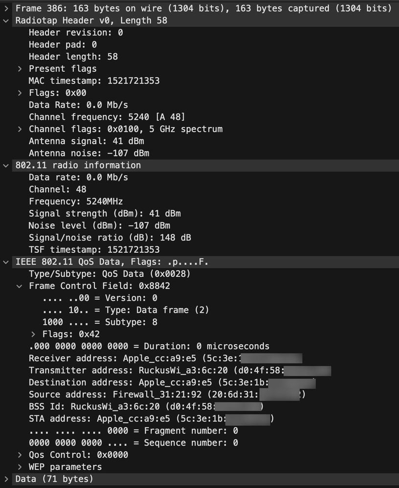

I pulled a Wireshark capture from my iPhone 14 Pro that was 10ft away, clear line of sight, to the R650:

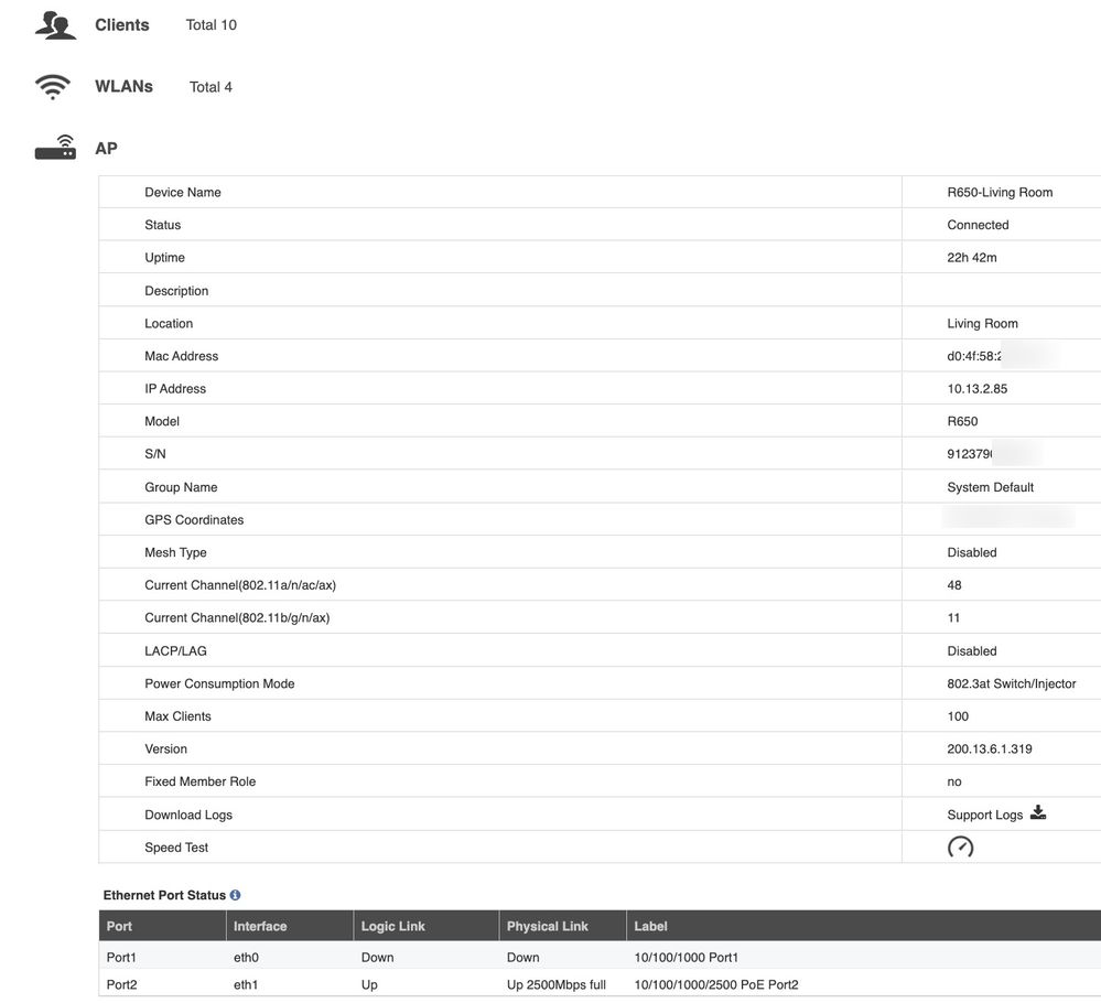

Screenshot of the Client Detail from the AP UI--> Navigate to Clients --> Select the client from the list --> Show Details.
Screenshot of the AP Info from AP UI --> Navigate to Access Points--> Select the AP in which the client is connected --> AP.

Thanks for jumping in! Here's the screenshot. The support logs are 3.5MB and have some personally identifiable info in there that I'd be glad to share privately.

Hi @Rucky860
The client RSSI and SNR seems to be good, but the Channalization is set to 80 MHz. With the current stats you are getting the good stats.
You can try increasing the Channalization if you need more speed.
