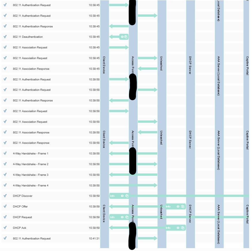

EDIT: added troubleshooting screenshot showing a re-connection failure after soft reboot.
Here is a screenshot showing the end of a troubleshooting trace I ran where I reproduced the re-connection failure. This was on the fourth consecutive soft reboot of the Eufy device - the first three the device re-connected OK. On the fourth, it just sits on the 802.11 authentication request step, as shown. The entire third reboot sequence, which is successful, is shown in its entirety as well.Re-connect fails

After updating to 200.19.7.11.283, the Eufy connection issues described in this thread immediately reoccurred. I then disabled PMF via CLI on the 2.4 IOT friendly WLAN but, sadly the Eufy connection issues persist even with the PMF disabled. So, it would appear the behavior is not related to PMF and I remain at a loss to understand what has changed in Ruckus FW versions 200.17+ that results in these connection issues on these specific devices.
Under 200.19, I have collected the debug, system and client connection log files and I have now reverted back to 200.15.6.212.27 where I expect the normal behavior will resume.
