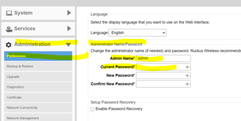

Hi Dan,
Whatever user name and the password is configured under Admin & Service >> Administrator >> Preference >> Administrator Name/Password, is the only user which can access CLI of the Unleashed. This is as per design.
Image_ images_messages_5f91c487135b77e247ad2c75_e248f467a52e0951a6726a3b1046c752_RackMultipart2020090769182878v-f011a639-aecb-47ee-b9c4-1504f14cd2d8-1329636692.png1599499817
Let us know if you are observing different behavior.
