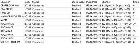

As a visual follow up.
2 physically close APs
Room01 39 clients
Room03 1 client
Image_ images_messages_5f91c413135b77e24794c86a_b4aa1d9d120e47b503a571e38ad559cd_AllAPsclients_inline-f137de69-d345-45ed-bf19-4abf9cb75e4b-342429958.jpg1393513539
