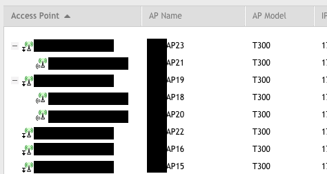

Below is the partial meshing setup for the network. AP17 is meshed with AP13 and is working absolutely fine, but AP21, AP19, AP20 and AP18 are not broadcasting.

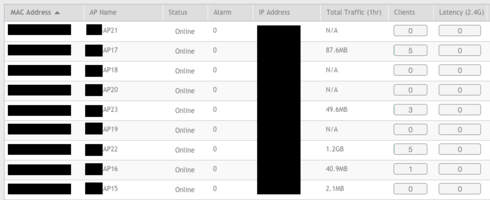

In the below screenshot the Total Traffic shows N/A. This already indicates to me the AP is not broadcasting. Also there is no channel on 2.4GHz and when checking the general AP details, the WLAN list is empty on the aforementioned APs.
