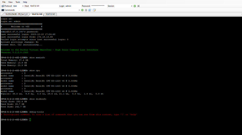

Can you share the below output from the both controller CLI
Login to CLI >> Type enable and put the password.
show meminfo
show CPU
show diskinfo
this is resources allocated in the controller:

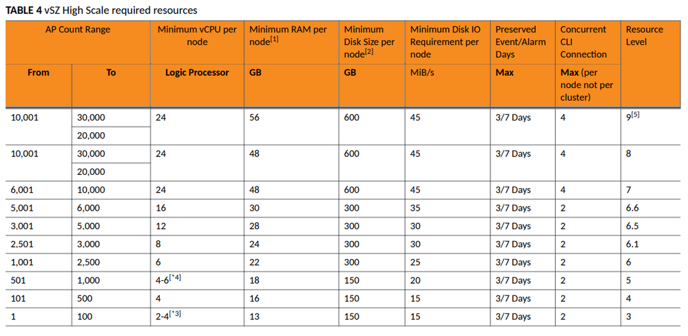

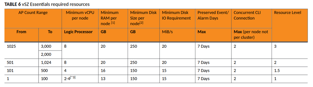

Any specific reason why the RAM and the HDD is more than the recommended resources?
Couple of options which we can try here:
Reboot the controller and try upgrading.
Shutdown the controller >> Set the resources level correctly >> Turn On the controller >> Then try upgrading.
Here is the resources details:
VSZ-E
VSZ-H
