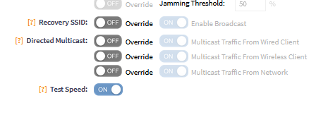

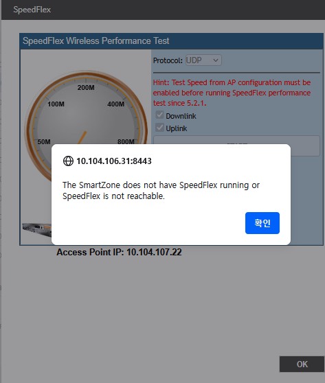

My customer using the sz144 wants to use the speedflex feature.
As shown in the attached screenshot, I enabled the speedflex feature and ran a test speed, but it's not working properly.
What should I fix?

Is SZ or AP behind NAT? I believe it does not work with NAT.
