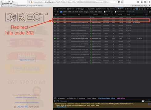

03-06-2018 02:51 AM
Hi Anthony,
will you get a redirect with http status 302 when you try to open URL? You can see it in a browser. See the place marked red

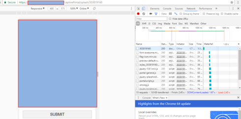

03-06-2018 03:54 AM
Hi Dmitry,
No I do not, only error 304, this is after I enter the URL manually.
