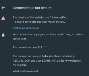

I have tried from Android device this morning and I think its to do with with our SSL certificate. We use a wild card certificate, is this what is causing the issue?

I have attached a screenshot of the error message.

@kuldev
So you are not facing the redirection issue but with the Certificate error?
On the browser, can you check the certificate details and see to which cert it is giving the error?
I mean if you click on the certificate details, see if the client is using the right certificate of the controller or not.
03-14-2023 02:28 AM
Looks like the error is to do with the Certificate. Our certificate is a wild certificate (*domain name) however our Guest Portal is IP Address:9997 From reading online the SSL certificate needs to be exactly matching and that's why its causing the error. Theoretically If I purchased another SSL certificate (Maybe a SAN) I could add the FQDN of our Guest Portal (i.e. the hostname of the Virtual Smart Zone) and the IP address of the Virtual Smart Zone. Would that work?
