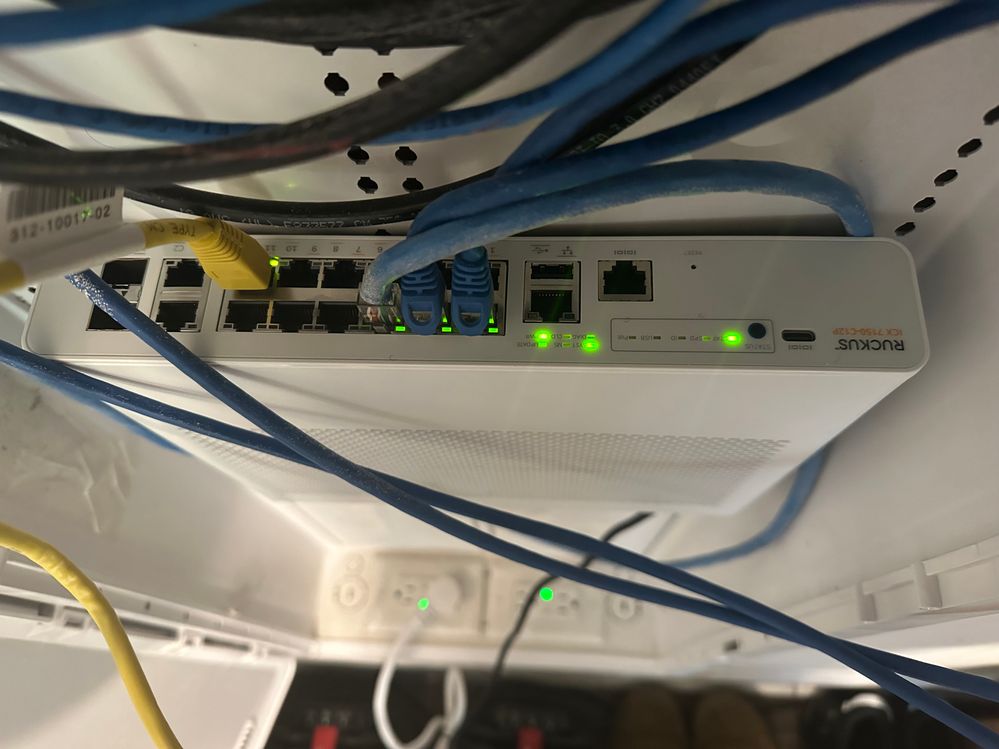

I am unable to get my switch (icx7150-C12) to respond to its IP address or connect to the system

2. On your switch while it's plugged into the outlet, do you see any lights on? (Amber or green) Please let us know which lights are on. (Please refer to the below picture and share a picture of the same, showing the light status and the FULL Switch panel cable connections to the Switch ports)

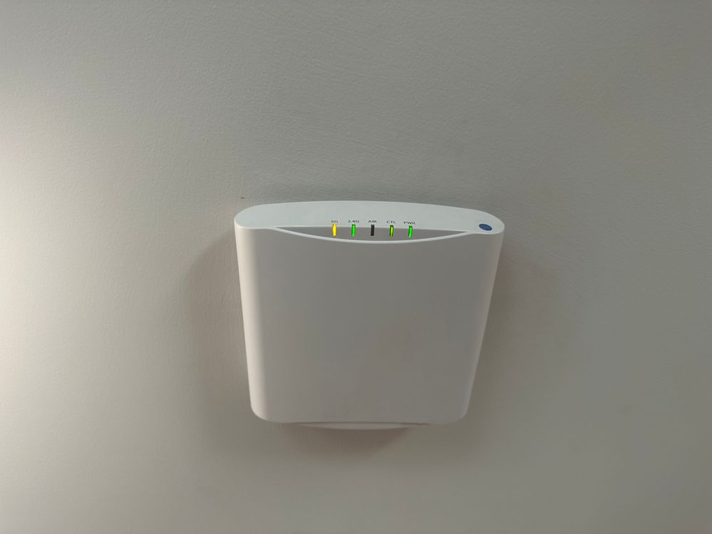

4. May I know how many Access Points are connected to the Switch? Could you please let me know the light status on the Access Points? Any of these lights are on (Please refer to the below picture and share a picture of the same)
08-25-2023 03:06 PM - edited 08-25-2023 03:14 PM
1. I have three access points 1 is a master.
2. My internet is stable
3. My system was working properly prior to a power outage. Once power came back online I updated the access points and they came back online however the switch has been disconnected. I just started a factory rest but I am unable to still connect to the IP address of the switch and it does not show when I scan the network for IP addresses

Please unplug the ethernet cable that is coming from the ISP Router (I believe it’s the yellow color I see in the picture you shared) and plug it into another port in any 1 in-12 ports as highlighted in the below screenshot.
Once it is done, please reboot (unplug and plug from the power outlet) your RUCKUS ICX-7150-C12P Switch and ISP (Internet Service Provider) Router. After the reboot is complete, please perform the IP Scan once again and check if there is any IP Address of Switch with the name Ruckus Wireless or Brocade Communications. Please share the screenshot of the same.

I have completed all of the above steps.
I am able to find the IP address for the switch through my router app. When I login to the dashboard and try to add the IP address to the switch it gives me the error message failed to ping ICX (shows IP address I put in). Suggest checking the network.
