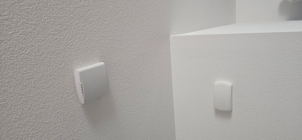

I have power blinking slowly green, but no lights for the control downstairs, and no internet.  the upstairs ruckus is working and has internet.  All of these problems happened after the power outage I have cable, but not able to access the internet which is affecting my home service for my alarm system and outside television.

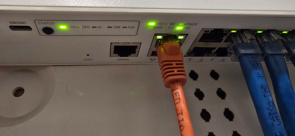

1.   On your switch while it's plugged into the outlet, do you see any lights on? (Amber or green) Please let us know which lights are on. (Please refer to the below picture and share a picture of the same, showing the light status and the FULL Switch panel cable connections to the Switch ports)

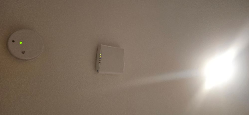

2.   May I know how many Access Points are connected to the Switch? Could you please let me know the light status on the Access Points? Any of these lights are on (Please refer to the below picture and share a picture of the same)
The light is blinking next to orange cableThe light is blinking next to orange cable20251110_110544.jpgupstairs wall unit connected to internetupstairs wall unit connected to internetdownstairs wall unit not connected to internetdownstairs wall unit not connected to internet

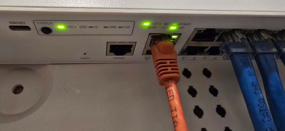

blinking light on this picture I caught the image when it was blinking.blinking light on this picture I caught the image when it was blinking.

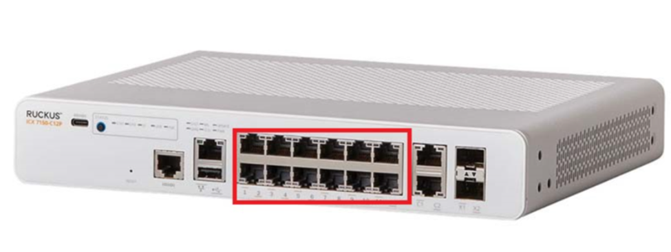

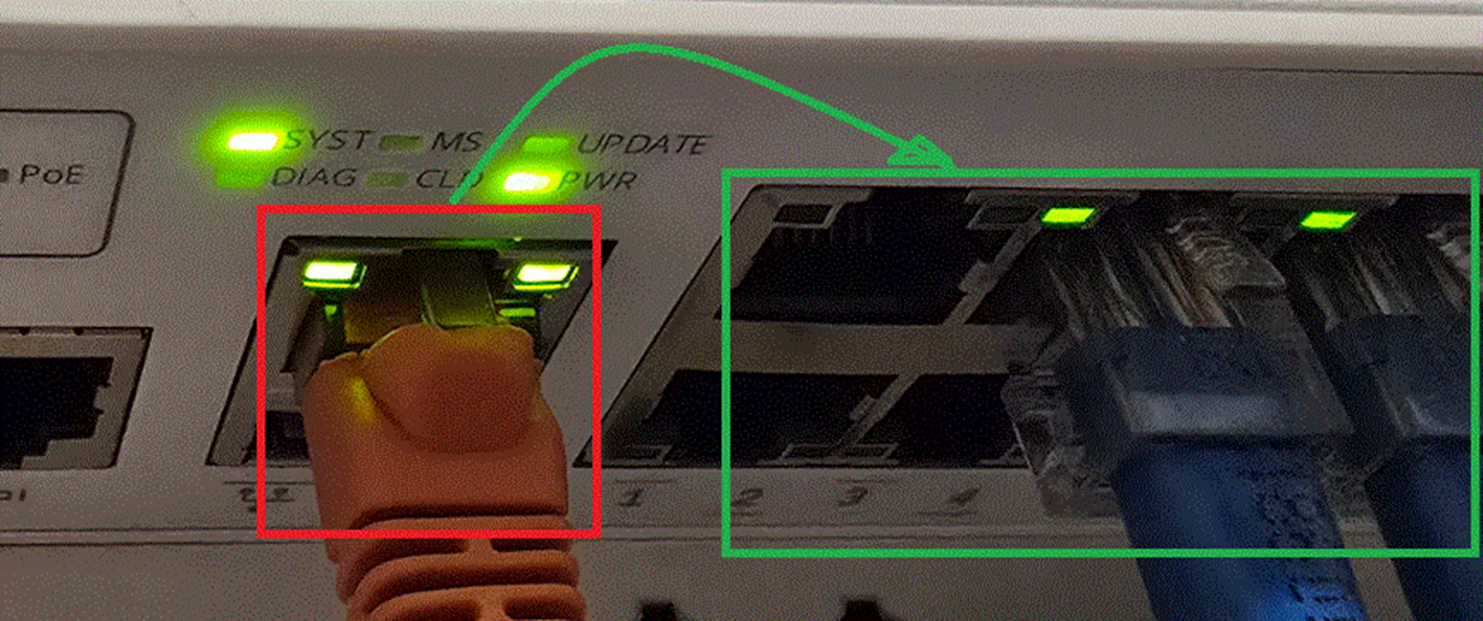

From the pictures you shared, it seems like the ethernet cable which is coming from the ISP’s (Internet Service Provider’s) Router or Modem/Router combo is plugged into the wrong port on the Switch panel. It must be plugged into any 1 in-12 ports as shown in the below screenshot.
1. Please unplug the ethernet cable and plug it into the correct port then reboot (unplug and plug from the power outlet) and try to connect to the Internet via Access Points.
It should be plugged into one of the 12 ports as shown in the below screenshot.
