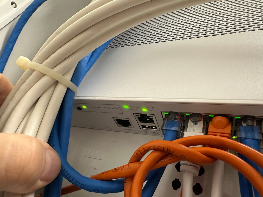

1. When your switch is connected to the outlet, do you observe any illuminated lights (amber or green)? Kindly describe which lights are visible. Additionally, please provide a photo showing the status of the lights and the full switch panel with cable connections to the switch ports.

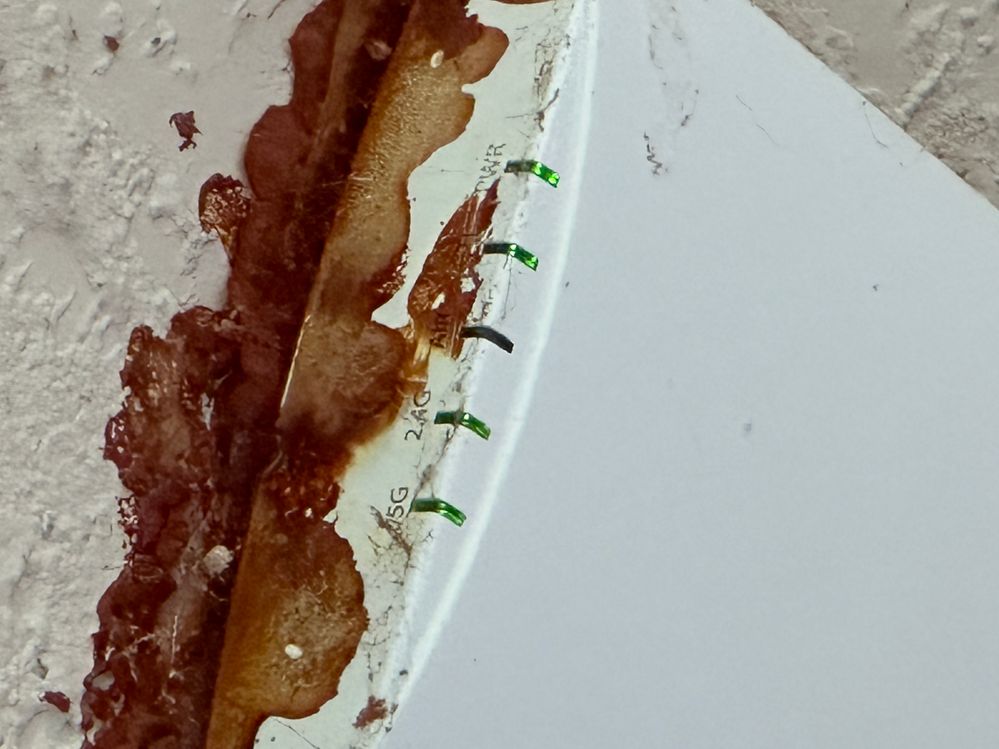

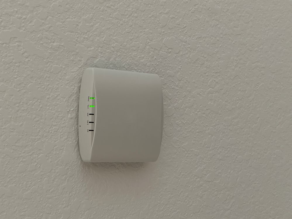

3. How many access points are currently connected to the switch? Please describe the status of the lights on the access points. Similarly, include a photo showing the access points' light status.

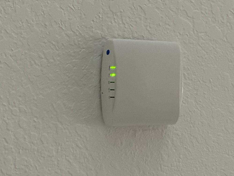

Imran -
Below you will find the images you requested. As you will see the only AP that is lighting up properly is our backyard unit. I've been using the wifi from our AT&T wireless router, which the Ruckus switch is plugged into.

03-04-2025 08:59 AM
Hi @adamz
Thank you for your prompt response and the detailed information you provided.
Kindly disconnect and reconnect the Ethernet cables of the Access Points (APs) and ISP Router's cable to the same port or any other available port within the range of 1 to 12, as indicated in the screenshot below.
After making this adjustment, after some time, please verify the Wi-Fi connectivity through the RUCKUS Access Points to ensure they are functioning as expected.
Feel free to update me on the outcome at your earliest convenience.
03-04-2025 10:46 AM
ok.. followed instructions. the AP outside is giving full bars and i see both networks 2.4Ghz & 5Ghz... all lights are on. The downstairs AP has two lights (the second is blinking) I don't get full bars on the 2.4Ghz and I do on the 5Ghz, but that might be coming from outside since there are only two lights on the AP. And upstairs only has one light on and i only see the 2.4Ghz and it's not full bars... and no 5Ghz.
