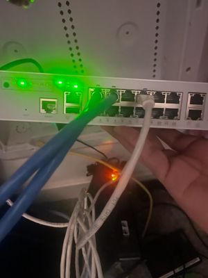

Could you please share a picture of the Switch panel showing port connections? (Please refer to the below screenshot)
Lennar Home Community.
04-10-2023 09:43 PM
the two blue are POE to the access points and the white is going into the ISP router
