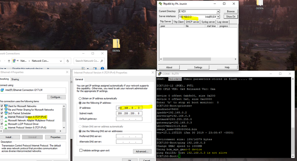

05-18-2023 04:17 PM - edited 05-18-2023 04:18 PM
I'm stuck at host is not alive.
