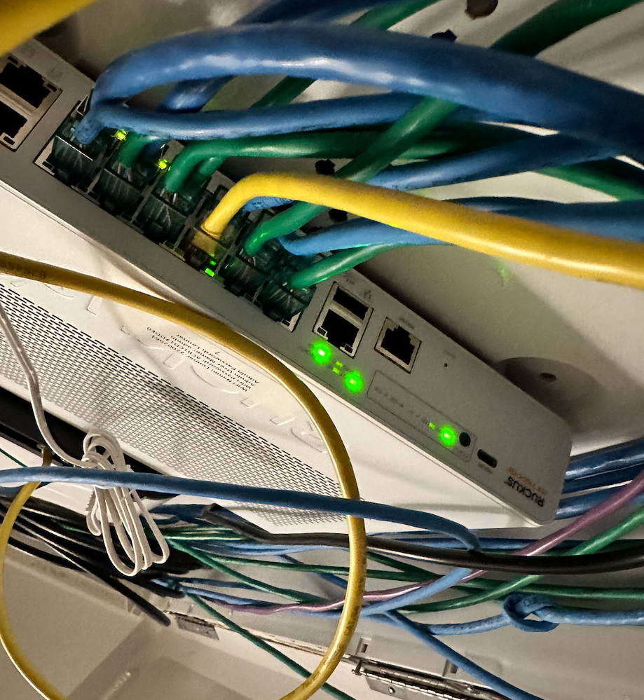

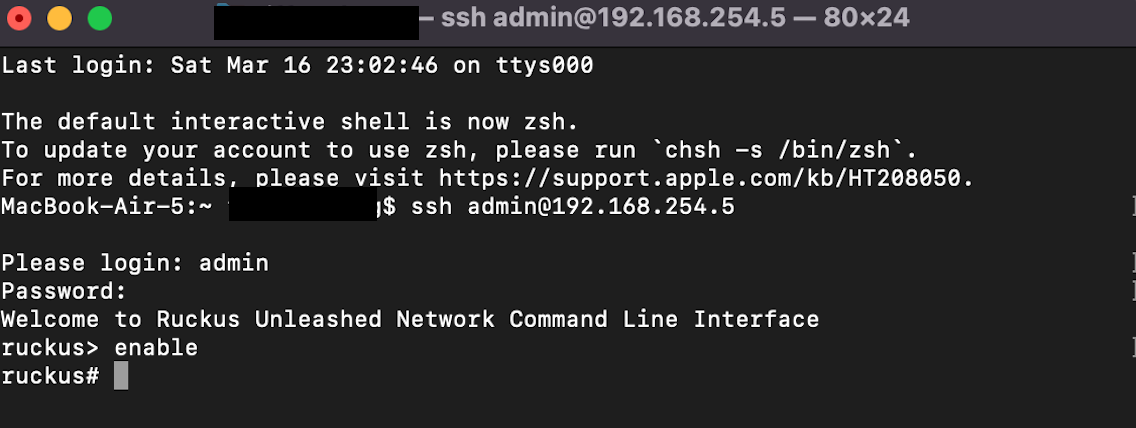

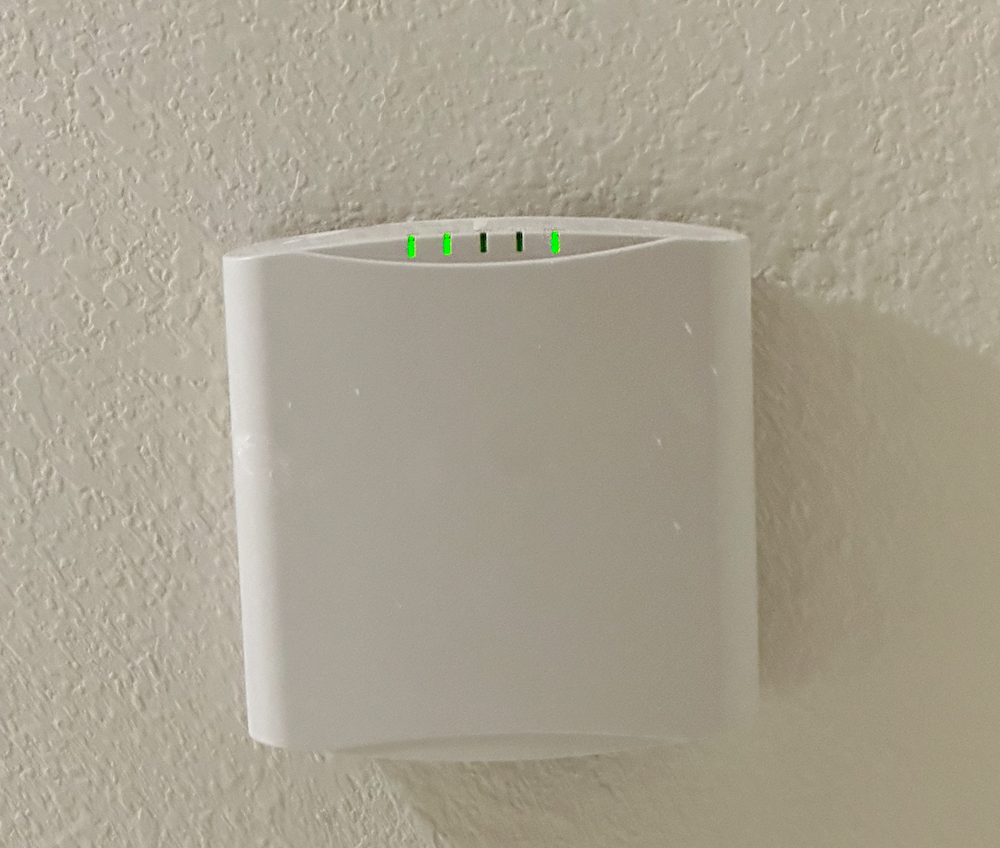

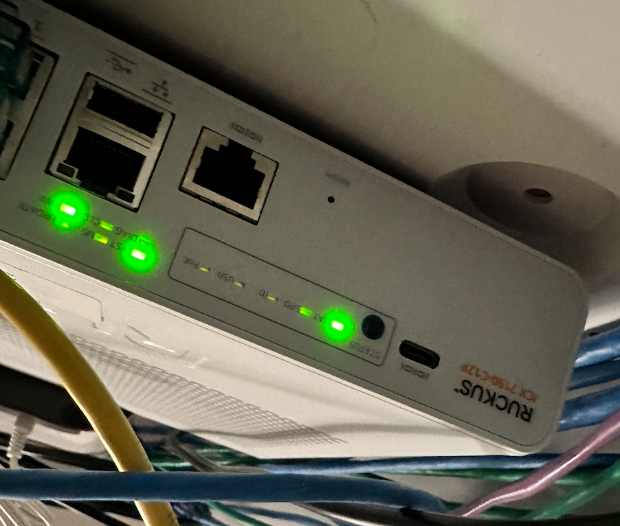

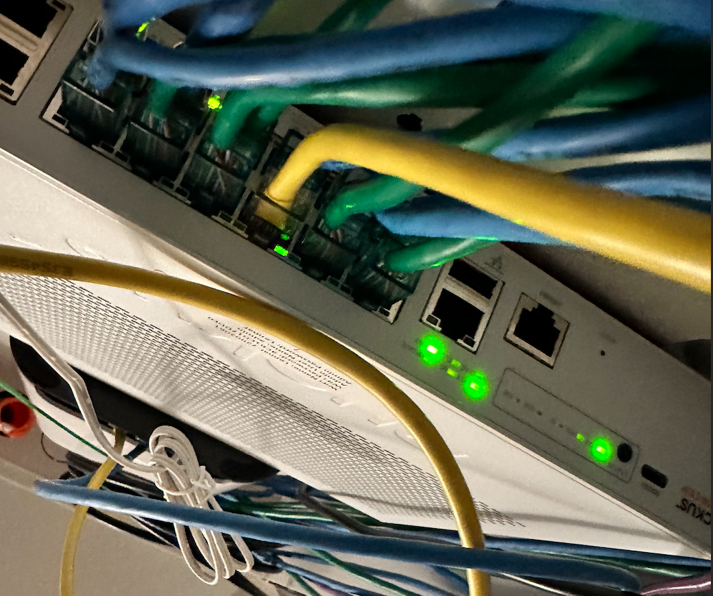

Good evening! I had a power outage last night and ever since, my Ruckus network has been super unstable. For the most part, it is super slow and will time out. I tried to do the CLI technical support that you have linked in serval other posts. But I am stuck because it doesn't quite show what others have shown.
I'm going to attach all my pictures and screenshots here.
I apologize for it being upside down

As you are seeing the ‘ruckus#’ prompt in CLI, it means you are using the Access Point’s IP address. Please use the RUCKUS ICX-7150-C12P Switch’s IP address. You should see 'ICX7150-C12 Router> OR ICX7150-C12 Switch>' prompts CLI.
Please check the other IP Addresses from the IP scan results, by the name of Ruckus Wireless or Brocade Communications to confirm the IP address of the Switch and access the CLI.
If you can access the Switch CLI, Please enter the below commands in to CLI and share the output.
show version
show flash

So... I saw two IP addresses that could be the ruckus, but none of them are the Switch's IP address.
I typed both IPs in the CLI - and you can see the results below. I do not see another IP address labeled as Brocade unfortunately.

Hi @tiffnguy
Please reboot (unplug and plug from the power outlet) your Internet Service Provider's (ISP) Router and RUCKUS ICX-7150-C12P Switch once and try find out the IP address once again once they come online after reboot.
