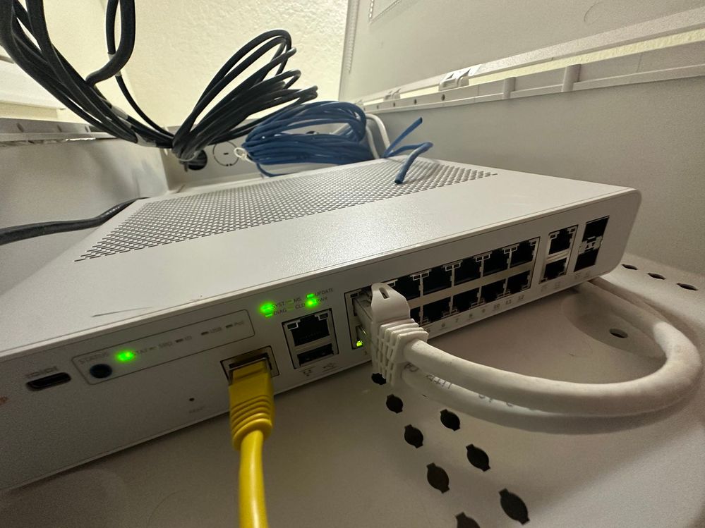

I am in a Lennar home and have a RUCKUS ICX7150-c12p with two R510 installed
I connect my spectrum modern to the ICX7150, two R510 connect to port 1 and 2. Powered up.

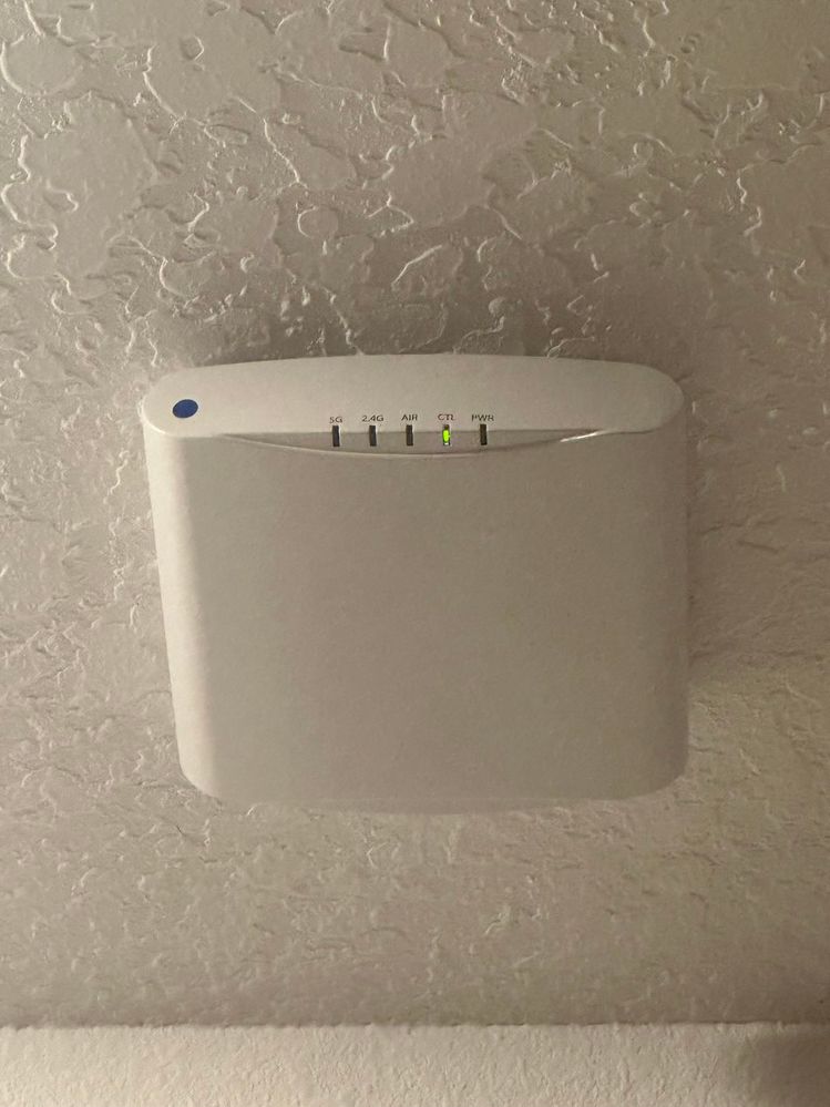

On the ICX7150,Syst and Pwr light are solid green. On R510, the CTL light is solid green and PwR light is flashing green.

2. May I know how many Access Points are connected to the Switch? Could you please let me know the light status on the Access Points? Any of these lights are on (Please refer to the below picture and share a picture of the same)

On the Switch,Syst and Pwr light are solid green. And we have 2 APs, on AP, the CTL light is solid green and PwR light is flashing green.

As per the light status of the RUCKUS ICX-7150-C12P Switch and the R510 Access Points, they seem to be in a normal status.
As I see from the picture you shared, it seems like the ethernet cable which is coming from the ISP’s (Internet Service Provider’s) Router or Modem/Router combo is plugged into the wrong port on the Switch panel. It must be plugged into any 1 in-12 ports as shown in the below screenshot. Please unplug the ethernet cable and plug it into the correct port. Then reboot (unplug and plug from the power outlet) your RUCKUS Switch and ISP Router once and try to connect to the Internet via Access Points.
Please confirm and let me know if you have any queries in this regard.
