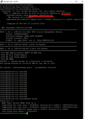

Here is the current version I am on SPS08080d

Your Upgrade folder should contain these 3 files shown in the below screenshot: (Refer the guide link for more information)
