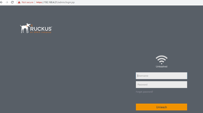

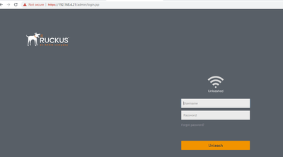

04-18-2023 01:29 PM
Neither are the Switch IP address. They both take me to the Ruckus admin log-in page.
04-18-2023 01:41 PM
Hi @mraybellwick
Both screenshots you shared have the same IP address, which is 192.168.4.21. Please try with another Ruckus Wireless IP address 192.168.4.61.
If you are getting the same results again, please try to run the IP Scan once again and check if there are any other Ruckus Wireless IP addresses for the Switch.
