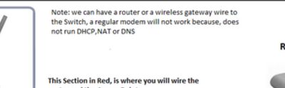

As you mentioned the ethernet cable from the Modem is connected to the RUCKUS ICX-7150-C12P Switch. If your ISP modem is directly connected to the ICX-7150-C12P Switch, it doesn’t work only with Modem. The connection must be from a Router or Modem-Router combo device. Could you please confirm this once?
Please refer to the short guide link below about how to connect the devices as a reference:
Hello Imran,
Thanks for the reply. I think the issue is Verizon only supplier me with a modem.
 I noticed this message in one of the images you shared. Is it necessary that we have a router to have it work? When I plug the modem into one of the 12 ports, I’m able to see my network, and connect for about 1 minute. After that, it drops and I stop getting internet. Is this expected?
