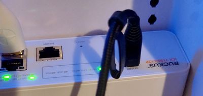

Please provide an image/photo where you are trying to connect via console from ICX 7150 - C12 P (USB type C to USB ) to PC. Before uploading the photos please login to the RUCKUS account and you can upload the image.

This is getting ridiculous. I have an icon to upload a photo, but it's not uploading. I don't have the same icon as your screen shot. I have the USB C plugged into the correct spot per your instructions. Also, when I tried to enter the boot bootrom code, it errored out.
