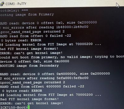

Tried resetting the ruckus 7150 and stuck still. Tried to reset with software and would not work.
08-05-2025 06:47 PM

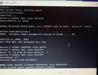

Tried resetting again and got this message
08-05-2025 07:22 PM
Here is the latest after the software still in boot loader

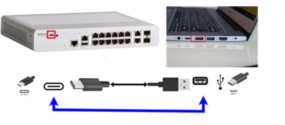

Based on the information you provided, I understand that you are encountering an error during the software recovery process.
Kindly share the details of the cable connections between the switch and your laptop for further review.
I would request you to please share the cable connection while performing software recovery. (Please see the below picture as reference)

After some trouble shooting I was able to get the ruckus out of bootloader and is now working. Should I update to the latest software version now or is it already by following those instructions
