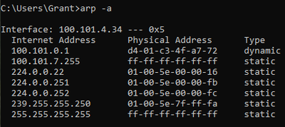

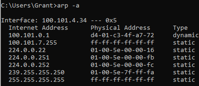

Here is what my Command Prompt screen shows:
(Connected to Ethernet)
(Connected to Wifi)

Based on the IP scan and Command Prompt results, it appears that the IP addresses are assigned statically, and the Access Point is not receiving an IP address.
Could you please check with your Internet Service Provider (ISP) or log in to your ISP router account to confirm whether Automatic IP assignment (DHCP) is enabled?
Basically, devices should get a Private IP address from the ISP's DHCP Server.
