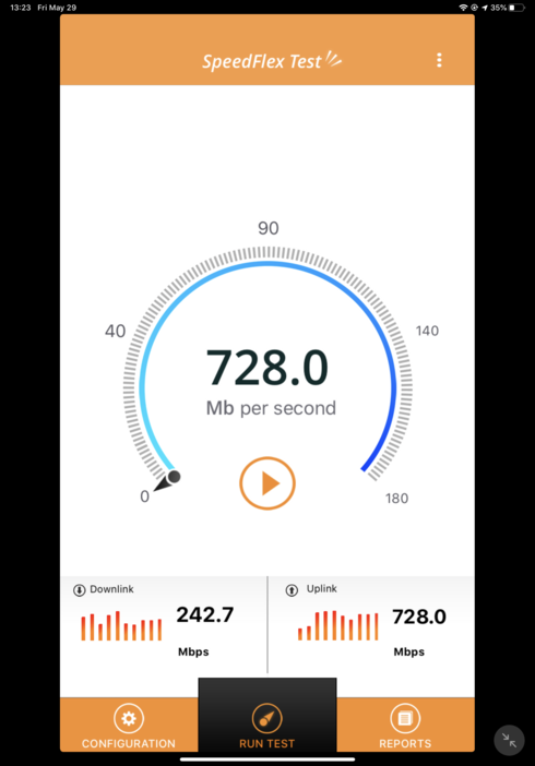

So far so good for the R710s, Performance seems as good as 200.6.10.1.312. When testing with iperf3
Image_ images_messages_5f91c481135b77e247ac119c_429e474310f91546e7ccdb6cf03a718b_RackMultipart20200529927231ws6-a47dea78-f379-4c94-9222-782c350ba275-411152508.png1590784011
It is better but downloads are still a long way behind upload speeds.
Getting soooooo tired of this.
Don’t use speedflex on the AP you are testing....test it on a separate AP that you are not connected to...
I did the mistake initially of testing with speedflex on the same ap as I was connected to......very different results on the r710/r610/r510/r500. I can’t say for the r720.
