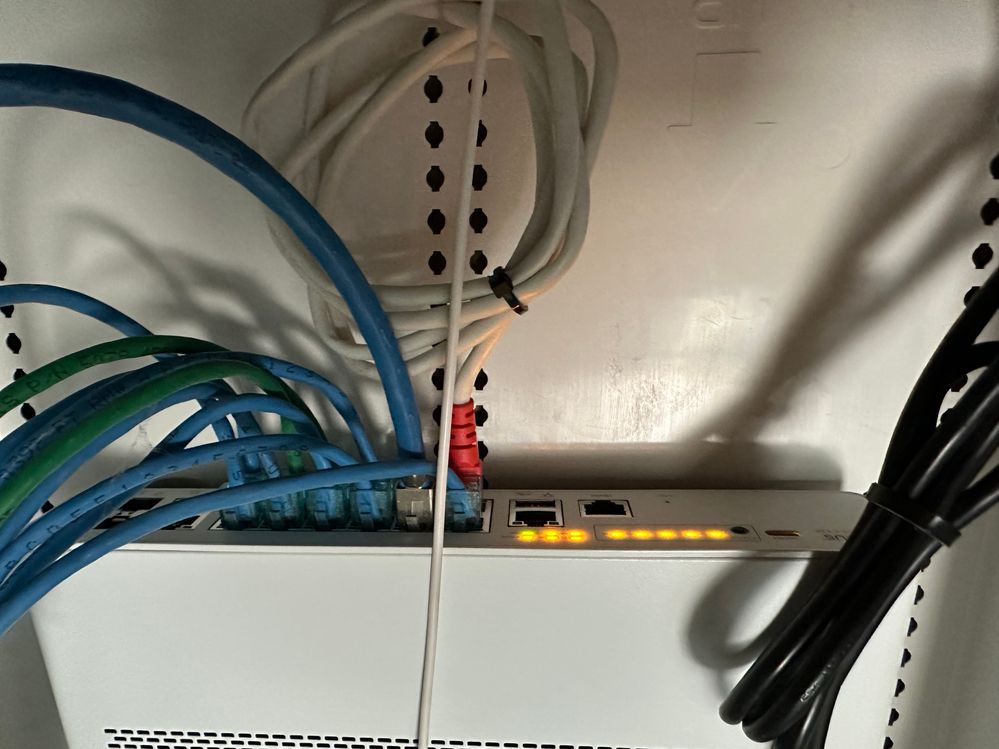

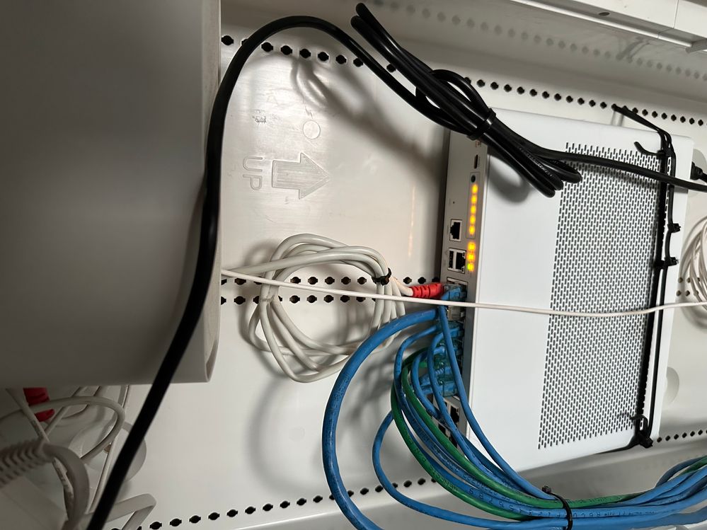

Hello Imran,
  1. Yes, the switch was operational prior. I don't recollect any significant power outage. If even there was one, it probably lasted a few minutes.
  2. No green light visible. Only amber lightAmber light is blinkingAmber light is blinkingAmber light blinkingAmber light blinking
The only green light visible is for power
Hi @charanrajan
Thank you for your response and for sharing the information.
This issue is occurring because the RUCKUS Switch is stuck in boot mode. If the reset attempts are unsuccessful, the only way to recover the Switch is by performing a Software Recovery.
