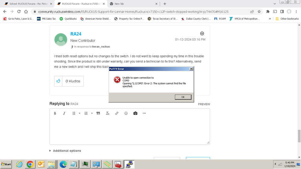

I get this  error   when connecting to PuttyCOM3 Putty errorCOM3 Putty error

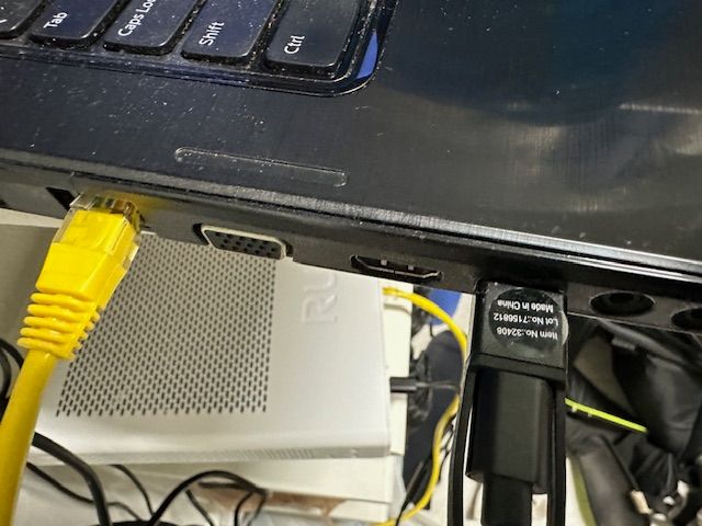

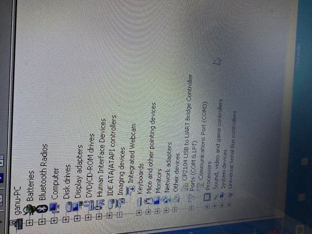

Hi @RA24
Please help us with a screenshot of the Device Manager showing the COM ports and a picture of software recovery cables connected between the Switch and the laptop.

Hi @RA24
Could you please download the below drives and check the COM port details once again?
Please make sure to download the zip drive for the file below & "extract all". Once it's extracted, run the file,  driver should be installed.
Link:https://support.ruckuswireless.com/software/1414-brocade-ruckus-7150-usb-serial-driver-windows
Link: silabs.com/developers/usb-to-uart-bridge-vcp-drivers?tab=downloads
