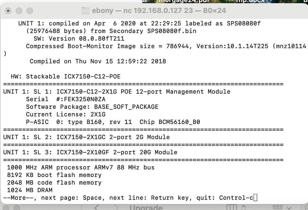

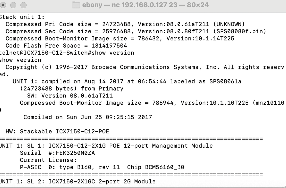

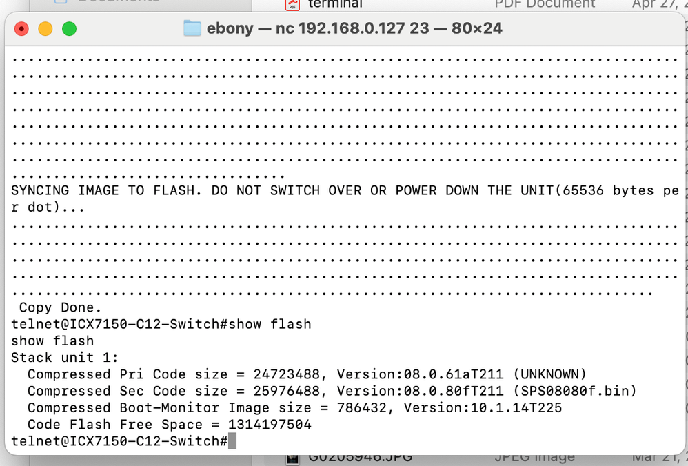

Hi I seemed to have an issue after step 3.
Hi  @ebalele
I see your RUCKUS Switch is now upgraded to a intermediate 08080f Version. Please enter the below commands and try upgrading your Switch using upgrade tool that works from 08080f version.
copy flash flash secondary
