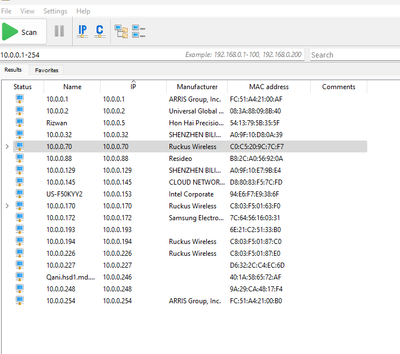

I was able to get the IP address , please see below . and not able to move forward . I need clear steps for next move . thanks
Hi @ajmalqani
As I see from the screenshot you shared, you have many IP Addresses from the name Ruckus Wireless, please check and confirm which is the RUCKUS ICX-7150-C12P Switch IP Address to access the CLI
Once you confirm the Switch’s IP Address, please download the Putty Application and try to log in to the CLI using the Switch IP Address from the IP Scan and share the output of the below commands.

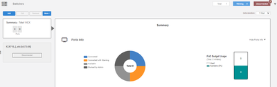

I am also experiencing  similar issues since the last two weeks.  I have all WAN connections connected as you suggested above. On the RUCKUS ICX-7150-C12P switch all status lights are green except USB is yellow.  When I logged into the switch I wasn't able to run all cmds:

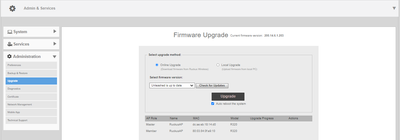

I also logged into the Ruckus Dashboard and see this:
I believe I found the version information here:
Appreciate your assistance on this,
Eric
